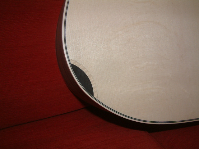

Hello everyone. I'm finishing up a Tele that has a myrtle drop top which is going to be colored with garnet shellac and then clear coated with lacquer. During the routing of ledges for purfling, a small slip occurred
This required a patch. The patch is pretty well matched in terms of grain, but I don't know the best way to try and hide the joint between the patch and the rest of the top. See attached picture. The patch is about where the strap button will be (if you have trouble seeing it - it looks like a highway billboard to me
I haven't tried any fixes yet, as I don't want to mess up the opportunity to do one fix by doing another incompatible fix first.

Guitar is a favor for a friend. He's getting it cheap, but the point is for me to learn, so I hate to send it out the door this way.
I'm hoping to come up with a way to dye or paint the joint, or something. Sawdust doesn't work well on light wood, does it?

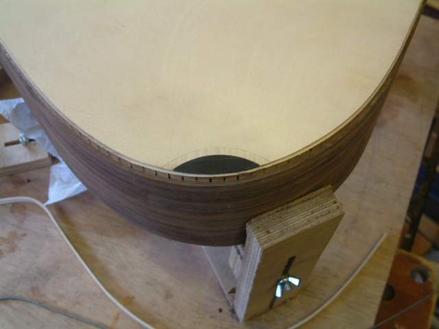

If you can easily route off the binding (I know the original routing caused the ding ) and put a wood inlay in there then re-bind. I put a ding in the lower bout edge of a guitar-bouzouki. As it was for a young rising traditional Irish player I did this after the top of a pint of Guiness :

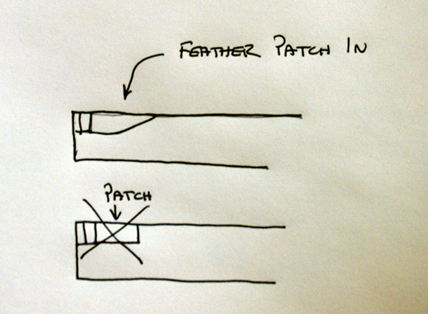

Your patch looks pretty good. You may consider not doing anything with it except burst the edges with garnet....
But,
I can't tell how you did the fix but if you taper it gradually and use hide glue it will usually be less noticeable.
Kind of like this:
Joe Beaver
Kind of like this:
Thanks for the lesson. My patch is just a butt joint against the edge of the cut.

Thanks everyone. It looks like the line may be able to take and hold a little filler putty - enough to cut down the contrast by 1/2 at least. I'm banking on it looking OK under the darker shellac color coats at that point.

Looks like the patch is done fairly well except what I believe what you're seeing is a small break to the edge of the pieces, or a small gap between them.
If you could tighten them up it may eliminate the visual. You matched the grain well though!!
